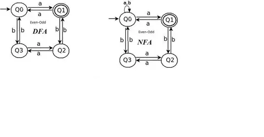

I am new to Automata theory and would to make a regular expression for "even-odd" strings, defined over $\Sigma = \{a,b\}$, which is the set of strings with even numbers of $b$'s and odd number of $a$'s. I am also interested in constructing a DFA and NFA for the language.
I tried
Even number of $b$'s = $(a^{\ast}ba^{\ast}ba^{\ast})^{\ast}$
Edit: I got DFA and NFA for odd number of $a$'s and even numbers of $b$'s and still unable to make regular expression which will allow only even number of $b$'s and odd nubmer of $a$'s . I also tried this Regular Expression
$(a(bb)^{\ast}(aa)^{\ast})^{\ast} $
Note: From above RE only those strings are generated which start from a but i want that RE which generate string of even number of $b$'s and odd number of $a$'s regardles of starting from a or b
EVEN-ODD DFA NFA
Khurram Ali
  • 149

Constructing a DFA (and thus an NFA), is quite trivial, so let's focus on the regular expression. (well, you can always convert a DFA into a regular expression, but this will not be very insightful, is it?)

Here is a pipeline of simple steps that leads you to the result:
  1. Build an automaton $A_a$ for $L_a = \{ w \in \{a,b\}^* \mid |w|_a \in 2\mathbb{N}+1 \}$.
  2. Build an automaton $A_b$ for $L_b = \{ w \in \{a,b\}^* \mid |w|_b \in 2\mathbb{N} \}$.
  3. Construct the product automaton $A$ for $L_a \cap L_b$.
  4. Convert $A$ into a regular expression.
The construction in 3. is a standard one I'd expect to be given in your lecture or textbook; usually, it's how we prove that the regular languages are closed against intersection.

The dumbest machine which builds strings in this language looks like:
                           [even, odd]
             (append "b") /           \ (append "a")
{start}  --> [even, even]               [odd, odd]
             (append "a") \           / (append "b")
                           [odd, even]
                              {end}
