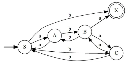

It seems to me that you may simply consider the automata with states S, A, B, C and exit state X, and with the following transitions:
S -a-> A
S -b-> C
S -b-> X
A -a-> S
A -b-> B
B -a-> C
B -b-> A
B -a-> X
C -a-> B
C -b-> S
DFA for your language
Right?
