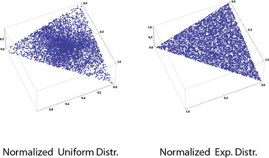

For your problem it would mean that you take $n-1$ random numbers from the interval $(0,1)$, then you add a $0$ and $1$ to get a list of $n+1$ numbers. You sort the list and then you record the differences between two consecutive elements. This gives you a list of $n$ number that will sum up to $1$. Moreover this sampling is uniform. This idea can be found in Donald B. Rubin, The Bayesian bootstrap Ann. Statist. 9, 1981, 130-134.
For example ($n=4$) you have the three random numbers 0.4 0.2 0.1 then you obtain the sorted sequence 0 0.1 0.2 0.4 1 and this gives the differences 0.1 0.1 0.2 0.6, and by construction these four numbers sum up to 1.
Another approach is the following: first sample from the hypercube (that is you forget about x+y+z=1) and then normalize the sample point. The normalization is a projection from the $d$-hypercube to the $d-1$-simplex. It should be intuitively clear that the points at the center of the simplex have more "pre-image-points" than at the outside. Hence, if you sample uniformly from the hypercube, this wont give you a uniform sampling in the simplex. However, if you sample from the hypercube with an appropriate Exponential Distribution, than this effect cancels out. The Figure gives you an idea how both methods will sample. However, I prefer the "sorting" method due to its simple form. It's also easier to implement.
Example of the 2 sampling methods

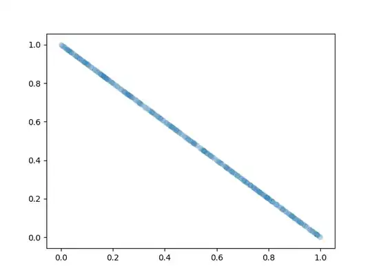

One other possibility is to use the Dirichlet distribution using the SciPy module. Essentially, if we set $\alpha=(1,\dots,1)^\top$, then the probability density is effectively uniform on a $n$-dimensional simplex where $n$ is the number of elements in $\alpha$.
Here is an example:
import numpy as np
from scipy.stats import dirichlet
n = 2
size = 1000
alpha = np.ones(n)
samples = dirichlet.rvs(size=size, alpha=alpha)
Now, if I plot it using matplotlib, we can see immediately see that it does a good job:
plt.ion()
plt.scatter(samples[:,0], samples[:,1], alpha=0.05)
An illustration of sampling from a two-dimensional Dirichlet distribution.
