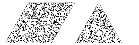

I would like to sample a uniformly random point in a polygon...
If sample a large number they'd be equally likely to fall into two regions if they have the same area.
This would be quite simple if it were a square since I would take two random numbers in [0,1] as my coordinates.
The shape I have is a regular polygon, but I'd like it to work for any polygon.

  1. Triangulate the polygon
  2. Determine in which of the triangles the point should lie (weights triangle areas)
  3. Sample the point in the triangle as explained in this post

One easy way is to find the bounding box for your polygon and use rejection sampling: sample from the bounding box and accept if it falls within the polygon, which will happen with probability $1/2$ at least (I think).
Another possibility is to triangulate your polygon. First sample a triangle in a proportionate way, then sample a random point in the triangle. The latter is simple: up to affine transformations, all triangles are of the form $\{(x,y) : x,y \geq 0, x+y \leq 1\}$. To sample uniformly a point from that distribution, first sample $x \in [0,1]$ according to the density $2(1-x)$ (i.e. sample a uniform $r \in [0,1]$ and compute $x = 1-\sqrt{1-r}$) and then sample $y \in [0,1-x]$ uniformly (i.e. sample a uniform $s \in [0,1]$ and compute $y = (1-x)s$). An even simpler method is to sample $x,y \in [0,1]$, and if $x+y > 1$ replace $(x,y)$ with $(1-x,1-y)$.
