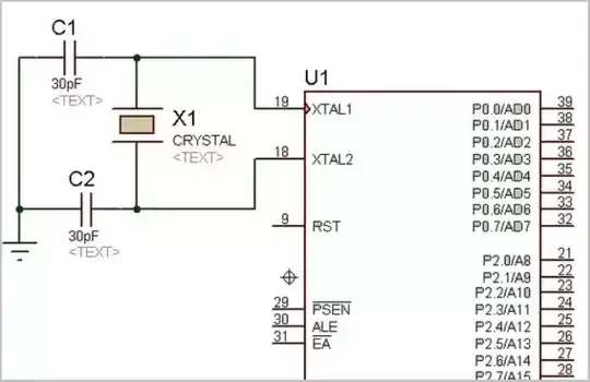

As seen in this link, the PIC microcontrollers have the CPU clock, with a rate of $f_{cy}$ (also called instruction cycle frequency), and the system clock, with a rate of $f_{osc}$ (oscillator frequency).
Physically, what provides the clock "ticks" to the microcontroller is a crystal oscillator. The oscillator basically has a crystal (X1 in the figure below) that when energized vibrates at a constant frequency.
[image ref]
The name "oscillator frequency", suggests that $f_{osc}$ is the input frequency of the microcontroller, that comes from the crystal oscillator. However, $f_{osc}$ usually refers to a scaled version of the crystal oscillator frequency, with PLL. The actual crystal oscillator frequency can be named as XTFREQ.
Fosc is the clock eventually with PLL, so with an 8MHz crystal and 4xPLL you would have an Fosc of 32MHz.

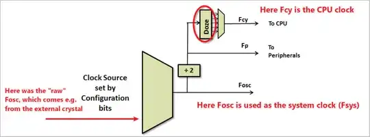

On the other hand, the CPU clock $f_{cy}$ is obtained by dividing $f_{osc}$ by 2 as seen in the image below (this depends on the microcontroller).
[image ref]
So a more precise statement would be that the "CPU clock can be much higher than the input crystal oscillator clock (XTFREQ)". Also, depending on the system the CPU clock can actually be lower than the system clock (as mentioned above) or higher [ref].
