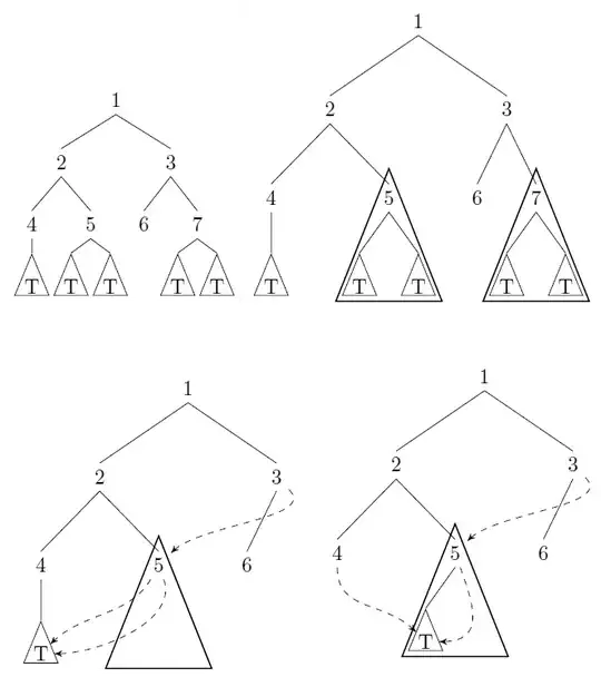

As pictures are not allowed in comments:
top left: an input tree
top right: the subtrees rooted in nodes 5 and 7 are isomorphic too.
lower left and right: the compressed trees are not uniquely defined.
Note that in this case the size of the tree has gone down from $7+5|T|$ too $6+|T|$.
