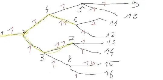

I'm looking for an efficient algorithm for the following problem:
Input: a binary, complete tree with a cost on each edge, an integer $k$
Output: the maximum-cost subtree containing $\le k$ edges
For purposes of this problem, a subtree is defined to be a connected subset of edges. Each edge of the tree has a cost, and the cost of a subtree is the sum of the costs of the edges in the subtree.
Only edges have a cost, which is always positive. The tree always has a root node from which only one path originates and from which we must search, in the example it is the node numbered 1. I read somewhere that it's possible to use a hashing function to compute it, but there was no explanation given.
I would also be interested to learn of an algorithm that works for graphs that aren't just binary trees.
Here's an example, with the desired subtree marked in yellow:
example tree
