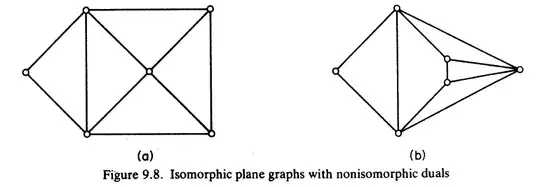

Does there exist a planar graph $X$ with two planar embeddings $G_1$ and $G_2$ such that $G_1^*$ and $G_2^*$ are the planar embeddings of nonisomorphic graphs $Y_1$ and $Y_2$? If so, what's an example construction. If not, why not?

The definition of the dual depends on the choice of embedding of the graph G, so it is a property of plane graphs (graphs that are already embedded in the plane) rather than planar graphs (graphs that may be embedded but for which the embedding is not yet known). For planar graphs generally, there may be multiple dual graphs, depending on the choice of planar embedding of the graph.

There is an answer in Graph Theory by Bondy and Murty:
It is clear that both graphs are isomorphic. Their respective duals are not, because each face of the first dual has degree 3 (except the unbounded one, of degree 5), and there are two faces of degree 4 in the second dual.
