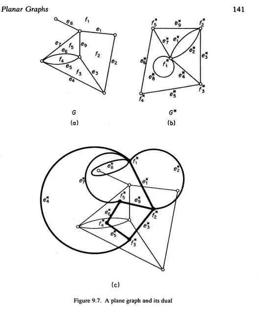

You can probably locate a copy of Bondy and Murty's book Graph Theory with its Applications. While they don't prove it either, they give the following intuition:
Let $G$ be a (connected) plane graph and $G^*$ its dual. There is a natural embedding of $G^*$ in the plane that corresponds to $G$, namely that each vertex $f^*$ in $G^*$ is placed in the corresponding face $f$ of $G$, and each edge $e^*$ is drawn such that it only crosses the corresponding edge $e$ in $G$ and it crosses it exactly once.
Bondy and Murphy proof sketch
