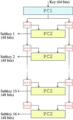

K16 presumably referes to the last sub key, per the key schedule. Each DES sub key is 48 bits long. enter image description here
Encoding a 56 bit key in 64 bits is done by adding a parity bit to each 7 bit byte. However I'm aware of no standard way of representing a 48 bit sub key as 64 bits.

There might not be enough information about where in the algorithm your 56 bit key is found.
If the 56 bit value B092EBA02E3798 represents the CD block following PC1 the keytab -s table shows selected key K16 is the result of applying PC2 to the CD block:

Without seeing the context of your assignment I'd suspect if the second method shown here were intended you'd be required to show your work, which would imply demonstrating PC1 and PC2 as well as mention of the key schedule demonstrating selected key 16 is PC2 applied to the CD block.
It helps to understand the Digital Encryption Standard is an interoperability standard referencing the hardware implementation found in IBM's two DES patents using a big-endian bit ordering from 1 and having an 8 bit interface to a host.
The relationship between the input key bytes, PC1, PC2 and CD block are shown in this answer to another question.

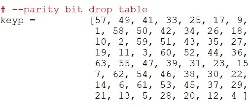

For ex. this is your 64 bit ${key = AABB09182736CCDD}$ you can convert to binary and then just arrange bits shown in keyp array and you will get new 56 bit key. new key as bitarray concatenated (bit5+bit49+bit41....+bit4), rest all bits are dropped. for Below array count starts from 0
  • getting 56 bit key from 64 bit using the parity bits key = permute(key, keyp, 56)
  • now after first permute PC1 above shown by Meir, the 56 bit key is '0xc3c033a33f0cfa'
  • If I understand your question correctly, you need to find 64 bit key from the 56 bits key, as Meir mentioned it is not feasible. you can use this 56 bit key after initial permutation and generate 16 48bit subkeys and use them in the reverse order while decryption. Please look for Feistel Cipher, as DES is based on it.
