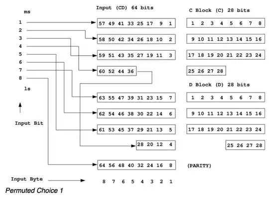

Permuted Choice 1 determines how an input block is loaded into C and D Registers:
Permuted Choice 1 is selection permutation describing how to load C and D registers from 8 successive bytes of input key, noting the LSB is only used for parity. (The big endian bit in byte ordering is from IBM).

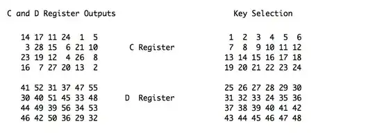

Permuted Choice 2 determines which C and D Register bits are used as input to f(R,K):
Permuted Choice 2 is also a selection permutation selecting two 24 bit values from each of the C and D 28 bit registers which are shifted according to the key schedule.

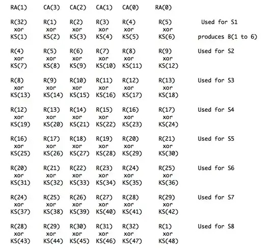

The DES standard also defines which selected Key bits are associated with each S Box:
This shows the E Permutation as values of R exclusive OR'd with selected key bits as input to the 8 S Boxes.
The Key Schedule causes rotations in the C and D registers bringing different key bits into play in different rounds.
