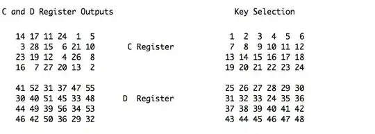

Permuted Choice 2
PC2 is a selection permutation. You might notice that the first 24 bits of the selected Key are from the C Register (CD(1 to 28)) and the second 24 bits are from the D register (CD(29 to 56)). The order of the selected Key bits in each have is non-linear.
PC2 expressed as two halves to show C and D
The left portion of the table is recognizable as PC2 from the Digital Encryption Standard.

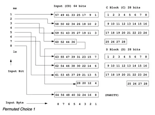

Permuted Choice 1
To demonstrate the how C and D Registers are concatenated we look to PC1.
PC1 to C and D Register Map
The above table shows how PC1 maps a 64 bit input to the two 28 bit C and D registers from an 8 bit interface where the LSB of each input byte is a parity bit and the upper 7 bits are used as key bits loaded into the C and D Registers. Once the C and D Registers are loaded they are independently shifted (recirculated) by either 1 position or 2 positions to distinguish each round key from it's neighbors. Shift direction is in the opposite direction for encryption and decryption, reversing the key schedule order.

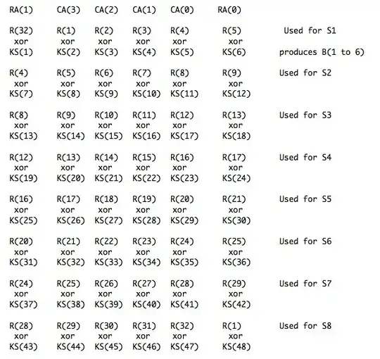

The following is a description of the inputs to each S Box in the round function f(R,K), expressed in E(R) and Ks bits.
S Box Inputs expressed in E(R) XOR KS
Each six bits of KS are applied to each of eight S Boxes after XOR with the matching E(R) permutation bits. The header row shows the Column Address bits (CA) and Row Address bits (RA) applied to each S Box.
f(R,K) can actually be devolved into operations associated with a nybble register of R, borrowing Row Address R bits from adjacent nybbles via the E permutation. C Register selected key outputs are applied to S Boxes 1 - 4, while D Register selected key outputs are applied to S Boxes 5 - 8.
