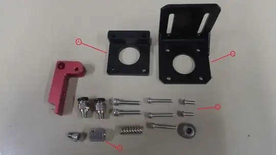

I'm building a Kossel Mini, and I'm stuck on the extruder motor holder.
My Kossel came without instructions, I was given a set of instructions by a friend (the "Kossel Build Guide" by Blomker industries). I also found some instructions on the net. However, my components are different from those in the build guides.
The question is how these components fit together.
I'm pretty certain the stepper motor should be connected to the big black components (labeled (1) and (4) in the picture). The 4 holes in these components correspond to openings in the stepper motor; and the stepper motors for the vertical carriages, were connected in a similar way to their respective holders.
The round thing, second from the left on the bottom, (labeled (2) in the picture) presumably goes on the axis of the stepper motor. Once again, a similar procedure was needed for the motors that will move the vertical carriages.
The screws on the right, labeled (3), are 1 cm long and 3 mm wide.
The other screws are 2 cm long and 3 mm wide.
The stepper motor is a Wantai Stepper Motor Model 42BYGHW811 .
I have e-mailed the company where I bought my kit and am awaiting their answer. Meanwhile I'm hoping to get some advice here.
Apparently the usual stepper motor for a Kossel Mini is Nema 17. Searching on "42BYGHW811" I mostly find datasheets. Using "Nema 17 mount" or "Nema 17 mounting screws" as search terms, I find a lot of images with a component like (1). But nothing on how this and the other components should be put together for the motor holder for an extruder for the Kossel Mini.

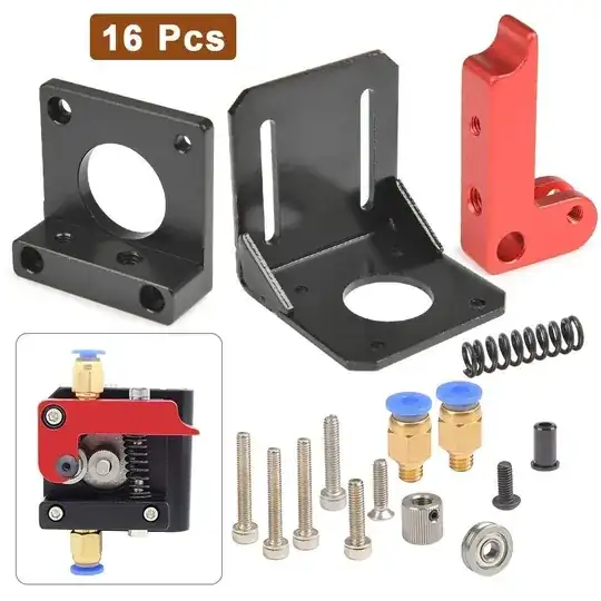

After a lot of searching, the closest that I could find (with an assembly diagram) is this product which has more or less the same parts as yours (apart from the small black bolt and sleeve - used as the axis - which you don't have): [Improved Version] YOTINO Right Hand MK8 Remote Bowden Extruder Accessories 1.75mm/3mm Filament All Metal Remote Extruder Frame Block for Reprap 3D Printer Kossel Prusa.
These are the parts:

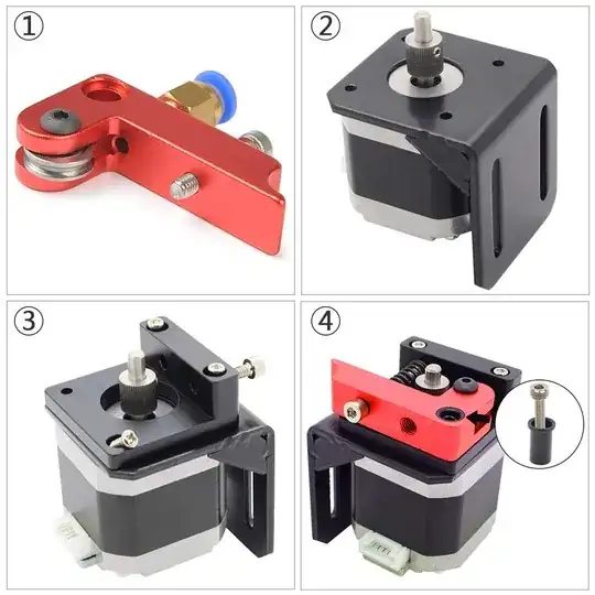

This is the assembly process:
Assembly process

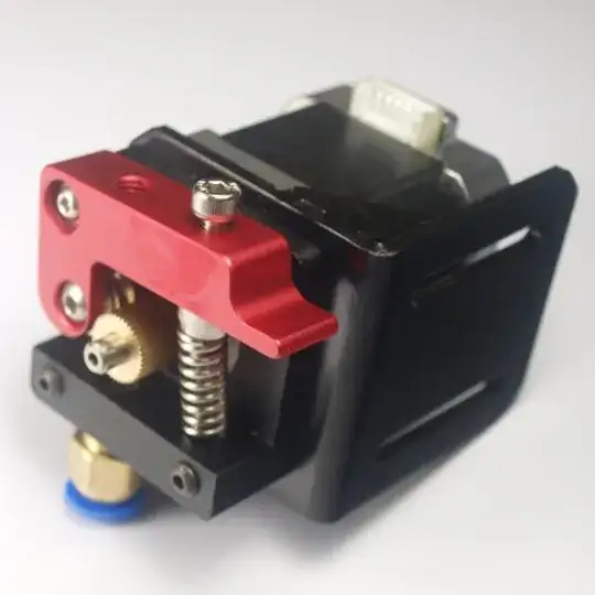

This is the completed extruder:
Completed extruder
