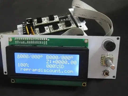

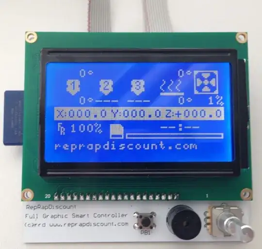

RepRap based printers use LCD modules with control button and SD card. You can trigger operations like
  • nozzle heating (to change filament)
  • extrude filament
  • home axis to caliber bed level
Most used LCD modules are:
RepRap firmwares (Marlin, Repetier) are supporting it. To get better view on what is supported, take a look on Marlin language file.
