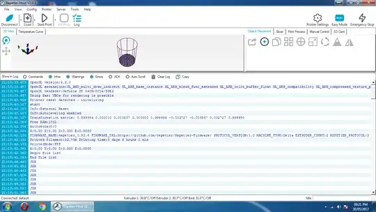

Here is a screenshot of Repetier host. The "JGR" continues indefinitely:
Screenshot of log
Here is the actual log text

22:56:09.726 : JGR
22:56:09.960 : N14 M105*18
22:56:10.972 : JGR
22:56:11.979 : JGR
22:56:12.969 : JGR
22:56:13.016 : N15 M105*19
22:56:14.028 : JGR
22:56:15.035 : JGR
22:56:16.025 : JGR
22:56:16.072 : N16 M105*16
22:56:17.085 : JGR
22:56:18.091 : JGR
22:56:19.081 : JGR
22:56:19.134 : N17 M105*17
22:56:20.157 : JGR
22:56:21.163 : JGR
22:56:22.154 : JGR
22:56:22.189 : N18 M105*30
22:56:23.202 : JGR
22:56:24.208 : JGR
22:56:25.199 : JGR
22:56:25.245 : N19 M105*31
22:56:26.253 : JGR
22:56:27.261 : JGR
22:56:28.267 : JGR
22:56:28.307 : N20 M105*21
22:56:29.319 : JGR
22:56:30.326 : JGR
22:56:31.316 : JGR
22:56:31.363 : N21 M105*20
22:56:32.376 : JGR
22:56:33.382 : JGR
22:56:34.372 : JGR

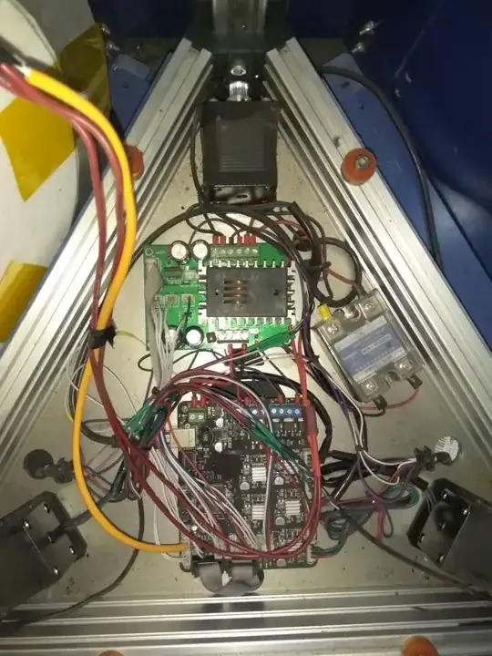

Edit: Since it is advisable to get a new controller board and keep the current one as it is, I'm attaching a picture of what my printer is controlled by.
The black box on the green board reads HRD 12008. Google says its a DC-DC SMPS module but mine has some extra connectors than what I could find online.
The black board is a MKS Base v1.3
The other box is a solid state relay.
This is more intimidating than I thought it would be. How do I proceed now? If I get a brand new controller board to play with, which should it be? Also, I can't seem to locate any RAMPS shield.

The reason that you have no RAMPS board is that, on your MKS board, the RAMPS and the Arduino are merged into one. Any new controller would work, as they all run the same firmware. There are many to choose from. As you are just experimenting (and reverse engineering) at this stage, I personally would buy a cheap Chinese Arduino Mega 2560 (€6) and RAMPS (€4) board on eBay, for a total of only €10 (if you buy them separately - don't get a combination "deal" as they are generally more expensive - although compare the prices first, you may find a bargain), to test your settings. Once you are happy with those settings, then you can spend more money on a better board, should you feel that you need it.
