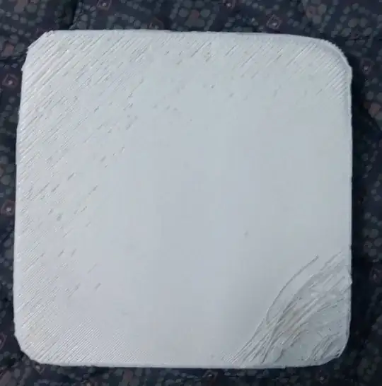

Edit2: Attached image is the bottom surface of the 100 mm cube. You might notice slight charring on the bottom right corner. The masking sheet I pasted on the print bed was charred underneath. Also, it's evident that the bottom surface is not as compact at the corners as it is in the center.
100mm cube bottom surface
What could be the possible reasons for that?

As detailed at minow.blogspot.com (which I found very helpful for the most part - it was the first link in the answer to my related question) you need to check/adjust the zero in front of each tower, check the zero in the center, tweak the radius, and repeat (checking the zeros at the edge of the bed in front of each tower again) until it's correct.
After that you adjust the rod length to correct XY size (and recheck all 4 zeros, thus the radius - it makes for a less than exciting day, but is worth it in the long run.)
You either need to turn off EEPROM until you have the right settings, or save the setting to EEPROM each time - depends how worried you are about using up EEPROM write cycles, I guess.
You should also turn off auto-bed-levelling while getting the basic calibration correct, per the same blog instructions.
