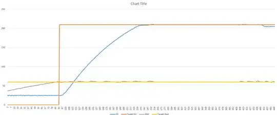

I have added a picture below, it has been like this already for about 15-20 min, no probs.

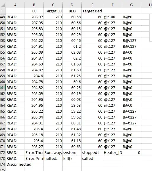

I updated all the images:

Thank you for updating the pictures (twice) and giving us the info to work with!
At the moment I see two things:
  • First, the printhead doesn't reach the 210 °C set into it in the last timeframe. After some time of printing, this forces TRP (Thermal runaway protection) as the board thinks: "HEY! my thermistor might be loose, I try to HEAT here!"
  • Second, your graph shows that in the first area, your printhead actually is able to reach the temperature. But something does change which prevents it from holding the temperature.
