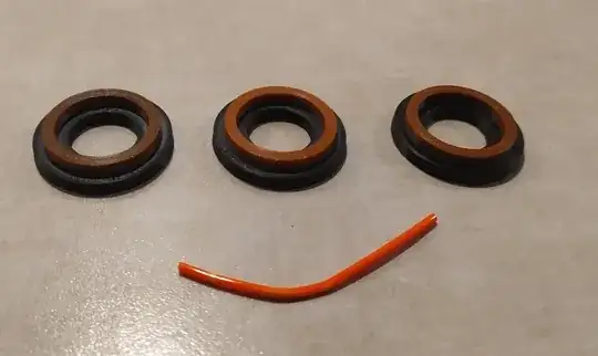

I'm printing in ABS. I want to make a 3 mm black plate, with an orange text/image on top of it. I've been playing with a test print and I can't seem to fix one thing. I swap the filaments and purge the nozzle, but no matter how much I purge, the orange filament keeps getting dark form some remnants of the black one.
Here's a sample of the original orange filament and different attempts with filament swap during print.
print sample
The orange has a recommended print temp. of 240-255 °C while for the black one its 230-250 °C. I've tried purging the hotend at different temperatures (240 °C, 250 °C) and I've been purging ridiculous amounts (like 1 meter). At the point where the filament looked clean I've resumed the print and it still came out dark. The continuous purging didn't clean everything and the extrusions and retractions during printing probably scooped out more of the black filament.
