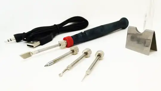

On dual extruder printers, e.g. on the Ultimaker 3 and S5, my colleagues have better experience using Ultimaker Breakaway filament rather than using PVA. As with the PLA supports, you need to "break them away" from the actual product; I use a Leatherman Charge or FREE P4 as these tools have fine pointed pliers. Note that there are removal tools available that are best described as soldering irons that can aid in the removal of support structures:
Modifi3d support removal tool
Note that I have mixed feelings about this product; it is hard to neatly remove supports using these small soldering irons, but it sometimes works.
