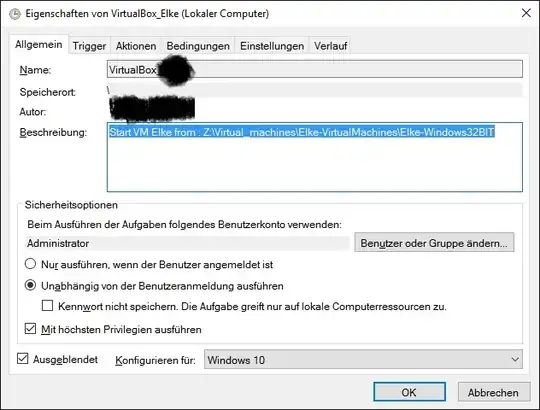

Problem : - Startup physical machine and automatic launch of VMs by sheduled task - login later on with my mainaccount (days or weeks later...no matter) - start "cmd", typing "vboxmanage list runningvms" does not showup any vms
My solution : 1- first open the component service DCOM
COMPONENTSERVICE
2- edit the highlighted component as followed :
Edit the accountsettings for launch
upon 2- enter the credentials for your account which shall see the Vms on the commandline
3- start task editor (in my case Windows 10) and follow the steps shown up. (i enabled the local administrator account and used it for the task. the DCOM component is launched by the settings defined in step 2)
Task sheduler "simple task step 1"
4- setup the starting parameters
Restart machine to bring the DCOM configuration changes on.
It should now visible with your entered logon account in the DCOM panel to show up the "vboxmanage list runningvms".
