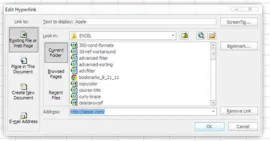

Manual
This is on a Windows 7 computer; just replace the shortcuts with their corresponding Mac counterparts.
  1. Highlight a cell with a hyperlink.
  2. Press CTRL+K. This opens the hyperlink dialog box (see image below). Once it opens, you'll find that your cursor is already in the Address field.
  3. Press CTRL+A to highlight the entire URL.
  4. Press CTRL+C to copy it.
  5. Press ESC or Enter to close the Hyperlink dialog box.
  6. Paste the URL somewhere via CTRL + V.
