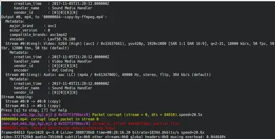

FFMPEG copy
Running this command:
> ffmpeg -i 00000084.mp4 -c copy 00000084--copy-by-ffmpeg.mp4
Gives this output:
[mov,mp4,m4a,3gp,3g2,mj2 @ 0x557f3798ecc0] Packet corrupt (stream = 0, dts = 84810).speed=20.5x
00000084.mp4: corrupt input packet in stream 0
[mov,mp4,m4a,3gp,3g2,mj2 @ 0x557f3798ecc0] stream 0, offset 0xe8d711da: partial file
00000084.mp4: Invalid data found when processing input
frame=84813 fps=1028 q=-1.0 Lsize= 3808738kB time=00:28:16.20 bitrate=18394.8kbits/s speed=20.6x
video:3727528kB audio:79510kB subtitle:0kB other streams:0kB global headers:0kB muxing overhead: 0.044648%
FFMPEG copy output
moov atom not found
