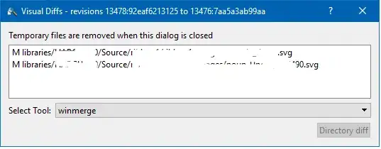

The simplest / most built-in way is:
- In the main listing of revisions, click/select the two that you want to compare
- Right click one of them
- From the context menu, select "Visual Diff..."
This will produce a window similar to the following example:
(Then just click the [X]).
This screen may have limited use however... for instance you can't readily export it, other than taking a screenshot. You can copy/paste the text of individual lines one-by-one, however.
