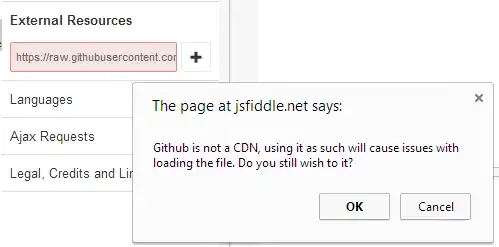

Unfortunately none of the answers here worked for me. The rawgithub URL didn't seem to work as the connection gets refused. So here's a full solution that did work. Firstly in GitHub you need to click the Raw button to get the original JavaScript.
Then copy the URL from the page it takes you too. You'll notice if you try and use this directly you'll get a warning from JSFiddle.
More to the point is the browser will give you an error, e.g.:
Refused to execute script from https://raw.githubusercontent.com/nnnick/Chart.js/master/Chart.min.js' because its MIME type ('text/plain') is not executable, and strict MIME type checking is enabled.
Take that URL and visit rawgit.com. This will give you a URL of the format https://rawgit.com/nnnick/Chart.js/master/Chart.min.js which you can then use.
