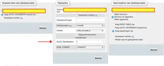

You can also do it using phpmyadmin. Just select the table than go to actions. And change the Auto increment below table options. Don't forget to click on start
