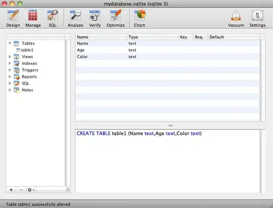

FYI the DB was created using SQLiteManager. SS below:
