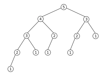

For example, here's a Fibonacci tree of order 5:
The Fibonacci trees represent the maximum amount of skew that an AVL tree can have, since if the balance factor were any more lopsided the balance factor of each node would exceed the limits placed by AVL trees.
