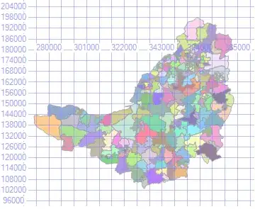

I have lots of Polygons of datatype Geometry in SQL Server 2008. The image below shows how a select of all these Geometrys looks visualized.
What I need to do is create a Polygon which represents the outer boundary of all these polygons. So I used the response given to a previous spatial question I asked to create the following code:
