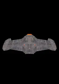

First, in case there is any confusion, here is the problem in pictures:
Step 1: I render a model.
Step 2a: I rotate it on the X-axis. Looks correct!
Step 2b: I rotate it on the Z-axis. Looks correct!
So... if I rotate on the model's X AND Z axis I want this:
But, sadface, I get this:
I can see the problem. I am appending the rotations one at a time in the global space. I need to rotate in the object's local space. I have NO idea how to do this or what I should even be searching for (terminology, etc.). The code is simple (and wrong):
