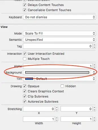

You can do it on main.storyboard in about 2 seconds.
Don't forget to add this piece of code from the delegate or your view will be cut off or appear behind the table in some cases, relative to the height of your view/label.
- (CGFloat)tableView:(UITableView *)tableView heightForHeaderInSection:(NSInteger)section
return 30;
