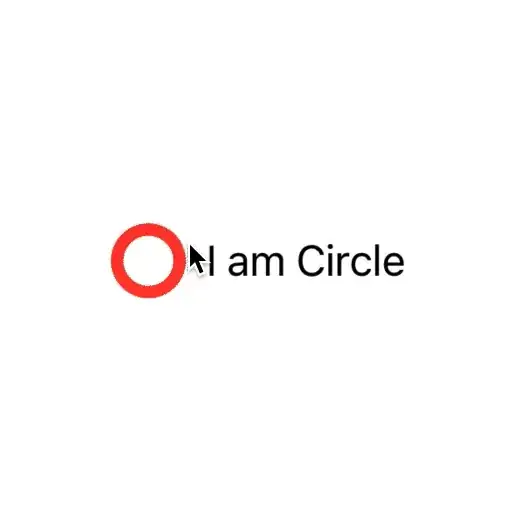

What you are seeing in your example is actually a transition from a circle+label with horizontal layout to a circle+label with vertical layout. But the two groups of views are independent of each other, so changes to properties like color are not being animated.
Your use of matchedGeometryEffect helps to smooth the transition from one layout to the other, but this is more due to luck than anything. This is because you have not identified a source. According to the documentation, results are undefined if "the number of currently-inserted views in the group with isSource = true is not exactly one". In other words, you are not using matchedGeometryEffect correctly.
For better control of the animation, I would suggest the following changes:
1. Combine the two layouts into one
Change the view structure so that there is only one circle and only one label. This is made tricky because you are changing the layout from horizontal to vertical, but one way to do it is to apply the circle as an overlay with computed offset:
