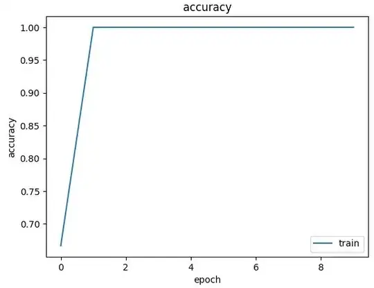

I appreciate replies from community members. I have learned a lot from this simple project. The previous sample sequences weren't adequate for the objective, therefore I used sequences of combinations of three elements as data input with their consecutive element as targets. With this modification, the resulting code is:
import numpy as np
import pandas as pd
import tensorflow as tf
from tensorflow import keras
data = ["A", "B", "C", "A", "B", "C", "A", "B", "C", "A", "B", "C", "A", "B", "C", "A", "B", "C", "A", "B", "C"]
prev_history = []
correct_guess = 0
for i in range(1,100):
input_size = len(data)
vocab = ["A", "B", "C"]
layer = keras.layers.StringLookup(vocabulary=vocab)
data_u = layer(data)
data_u = data_u - 1
seq_length = 3
dataset = keras.utils.timeseries_dataset_from_array(
data_u.numpy(),
targets = data_u[seq_length:],
sequence_length = seq_length,
batch_size = 2
model = keras.Sequential([
keras.layers.SimpleRNN(32, activation='relu', input_shape=[None,1]),
keras.layers.Dense(3, activation='softmax')
model.compile(loss='sparse_categorical_crossentropy', optimizer='adam', metrics=['accuracy'])
model.fit(dataset, epochs=10, shuffle=True)
if prev_history != []:
if data[-1] == prev_history[-1]:
correct_guess += 1
if len(prev_history) > 0:
correct_guess_rate = correct_guess/(len(prev_history))
x_pred = data_u[-seq_length:]
x_pred = tf.reshape(x_pred, [1,seq_length])
predchance = model.predict(x_pred)
max_n = np.argmax(predchance)
pred = layer.get_vocabulary()[max_n+1]
prev_history.append(pred)
choices = ["A", "B", "C"]
data.append(choices[input_size % len(choices)])
With this code, the predictions were very accurate. I tried different patterns, and the predictions are consistently superior to random choices.
