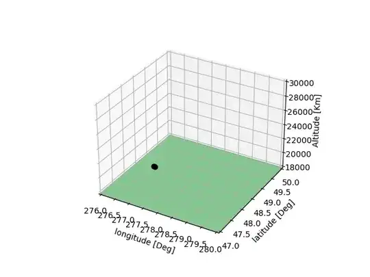

This answer shows how to create the final plot that you asked for. Both requests (single color and connected line) are very possible. A Google search of your desired plot image shows that it was originally an animation, which is something else that I have included.
Answer
Use ax.plot(...) instead of ax.scatter(...) in order to connect the points with a line. Then you can add a few other features to make the output look more like your end goal.
Example Output
Here is a figure showing your end goal. The code to reproduce the figure is added below.
It is also possible to create an animation of the plot over time. Note that the color of the lines changes as the distance from the start position increases. This feature is easily disabled.
Code
This is some setup code to be used for both static and animated figures.

This is for the static version of the figure.
# creating the main figure and setting boundaries (change these as needed)
fig = plt.figure(6)
ax = fig.add_subplot(111, projection='3d')

This is the code to create an animated version of the plot over time.
# create figure/axis with appropriate params
fig = plt.figure(6)

def animate(i, colUpdate, numFrs): # colUpdate (bool), numFrs (int)
# update the data for the path lines
line.set_data(lon[0][:(i+1)*2],lat[0][:(i+1)*2])
line.set_3d_properties(Z[0][:(i+1)*2])
line1.set_data(lon[1][:(i+1)*2],lat[1][:(i+1)*2])
line1.set_3d_properties(Z[1][:(i+1)*2])
# update the data for the vertical lines
vertLine.set_data(np.array([lon[0][((i+1)*2)-1],lon[0][((i+1)*2)-1]]),np.array([lat[0][((i+1)*2)-1],lat[0][((i+1)*2)-1]]))
vertLine.set_3d_properties([np.min(Z[0]),Z[0][((i+1)*2)-1]])
vertLine1.set_data(np.array([lon[1][((i+1)*2)-1],lon[1][((i+1)*2)-1]]),np.array([lat[1][((i+1)*2)-1],lat[1][((i+1)*2)-1]]))
vertLine1.set_3d_properties([np.min(Z[1]),Z[1][((i+1)*2)-1]])
# update the data for the endpoint dots
dot.set_data(lon[0][((i+1)*2)-1],lat[0][((i+1)*2)-1])
dot.set_3d_properties(Z[0][((i+1)*2)-1])
dot1.set_data(lon[1][((i+1)*2)-1],lat[1][((i+1)*2)-1])
dot1.set_3d_properties(Z[1][((i+1)*2)-1])
# update the colors, if necessary
if colUpdate:
co = np.array([(i/numFrs),0.0,0.0])
co1 = np.array([0.0,0.0,(i/numFrs)])
line.set_color(co)
vertLine.set_color(co)
dot.set_color(co)
line1.set_color(co1)
vertLine1.set_color(co1)
dot1.set_color(co1)
# return all updated objects
return line, vertLine, dot, line1, vertLine1, dot1,
# set params and create the animation artist
updateCol = True
numFrames = int(len(Z[0]) /2)
anim = FuncAnimation(fig, animate, frames = numFrames,interval = 100, fargs=(updateCol,numFrames,), blit=False, repeat=False)
# Show the plot!
plt.show()
