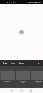

Inkwell Ripple effect is not showing the full area of content. In my scenario, I have a column that contains a container with a color that can't make as transparent after a container there is a simple text widget. I wrapped the inkwell with full content, When I tapped on the content ripple effect showed only the text area, and some transparent area ripple effect not showing on the top container which has height, width, and a specific color. The especially problem is here ripple not showing on the container area. I wanted to show a ripple effect on the full area of content.

My code:
class LayoutSizeItem extends StatelessWidget {
const LayoutSizeItem({super.key});
@override
Widget build(BuildContext context) {
return Align(
alignment: Alignment.center,
child: Padding(
padding: const EdgeInsets.symmetric(horizontal: 4.0),
child: Material(
color: Colors.transparent,
child: InkWell(
onTap: () {},
splashColor: Colors.pink,
child: Column(
mainAxisAlignment: MainAxisAlignment.center,
mainAxisSize: MainAxisSize.min,
children: [
SizedBox(
height: 80.0,
child: AspectRatio(
aspectRatio: 1.5,
child: Container(
color: Colors.grey[700],
const SizedBox(
height: 4.0,
const Text(
"(1400x1440)\n1:1",
textAlign: TextAlign.center,
style: TextStyle(fontWeight: FontWeight.w300, fontSize: 10.0),
