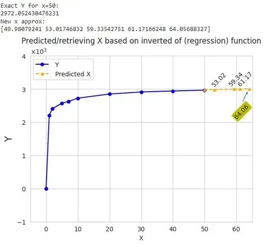

# Create regression formula based on @Reinderien
import numpy as np
a = -0.007823866
b = 0.2984279
c = 0.1652267
d = 3512.422
def forward(x):
return d + (a - d)/(1 + (x/c)**b)
def inverse(y):
return c*((y - a)/(d - y))**(1/b)
# find Y value for 50 using formula
d_new = np.array((50))
dd_new = forward(d_new)
print('Exact Y for x=50:')
print(dd_new)
#Excat Y for x=50:
#2972.052430476231
y_new = np.array((2972, 2980, 2995, 2999, 3005))
x_new = inverse(y_new)
print('New x approx:')
print(x_new)
#New x approx:
#[49.98079241 53.01746832 59.33542751 61.17166248 64.05688327]
#df=df.astype(float)
df.X = pd.to_numeric(df.X)
df.Y = pd.to_numeric(df.Y)
#visulize the regression data
from matplotlib import ticker
import seaborn as sns
sns.set_style("whitegrid")
ax = df.plot.line(x='X', y='Y', marker="o", ms=5 , label=' Y', c='b')
plt.plot(x_new, y_new, marker="^", ms=5 ,label=' Predicted X', linestyle='--', c='orange')
plt.xlim(-5, 65)
plt.ylim(-1000, 4000)
#plt.yscale('log',base=1000)
plt.ylabel('Y', fontsize=15)
ax.annotate(f'{x_new[1]:.2f}', xy=(2, 1), xytext=(x_new[1] -1 , y_new[1] +100), rotation=45)
ax.annotate(f'{x_new[2]:.2f}', xy=(2, 1), xytext=(x_new[2] -2 , y_new[2] +100), rotation=45)
ax.annotate(f'{x_new[3]:.2f}', xy=(2, 1), xytext=(x_new[3] -1 , y_new[3] +100), rotation=45)
ax.annotate(f'{x_new[4]:.2f}', xy=(x_new[4], y_new[4]-50), xytext=(x_new[4] -5 , y_new[4] -900), rotation=45, bbox=dict(boxstyle="round", fc="y"), arrowprops=dict(arrowstyle="simple", connectionstyle="arc3,rad=-0.2"))
formatter = ticker.ScalarFormatter(useMathText=True)
formatter.set_scientific(True)
formatter.set_powerlimits((-1,1))
ax.yaxis.set_major_formatter(formatter)
plt.title('Predicted/retrieving X based on inverted of (regression) function')
plt.legend(loc = "upper left")
plt.show()
Note: Alternatively, you can also use pynverse for calculating the numerical inverse of any invertible continuous function.
Basically, you just need to find the inversion of (regression function) formula that describes your model to find new Xs according to new given Ys. You don't need to fit a curve over your data necessarily.

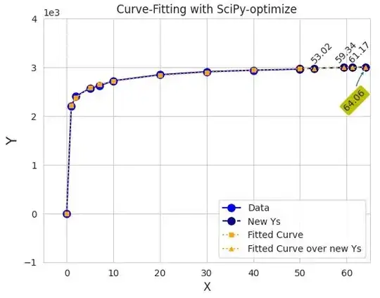

- Fitting curve using scipy package:
# fit a second degree polynomial to the data
import numpy as np
from scipy.optimize import curve_fit
# define the function
a = -0.007823866
b = 0.2984279
c = 0.1652267
d = 3512.422
def function(x, a, b, c, d):
# choose the input and output variables
x_data, y_data = np.array(df.X), np.array(df.Y)
print(x_data)
print(y_data)
p0 = [a, b, c, d]
# perform the curve fit
popt, pcov = curve_fit(function, x_data, y_data , p0=p0)
#popt, _ = curve_fit(forward, x, y)
# summarize the parameter values
print(popt)
## plot the results
#plt.figure()
plt.plot(x_data, y_data, marker="o", ms=8 , label="Data" , c='b')
plt.plot(x_new, y_new, marker="o", ms=8 , label='New Ys', linestyle='--', c='darkblue')
plt.plot(x_data, function(x_data, *popt), linestyle=':', c='orange', marker="s", ms=5, label="Fitted Curve")
#just for show case once if we could extend our fit cure over new data
plt.plot(inverse(y_new), y_new, linestyle=':', c='orange', marker="^", ms=5, label="Fitted Curve over new Ys")
plt.ticklabel_format(axis="y", style="sci", scilimits=(0,0))
plt.xlim(-5, 65)
plt.annotate(f'{x_new[1]:.2f}', xy=(2, 1), xytext=(x_new[1] -1 , y_new[1] +100), rotation=45)
plt.annotate(f'{x_new[2]:.2f}', xy=(2, 1), xytext=(x_new[2] -2 , y_new[2] +100), rotation=45)
plt.annotate(f'{x_new[3]:.2f}', xy=(2, 1), xytext=(x_new[3] -1 , y_new[3] +100), rotation=45)
plt.annotate(f'{x_new[4]:.2f}', xy=(x_new[4], y_new[4]-50), xytext=(x_new[4] -5 , y_new[4] -900), rotation=45, bbox=dict(boxstyle="round", fc="y"), arrowprops=dict(arrowstyle="simple", connectionstyle="arc3,rad=-0.2"))
plt.title('Curve-Fitting with SciPy-optimize')
plt.legend(loc = "best")
plt.show()

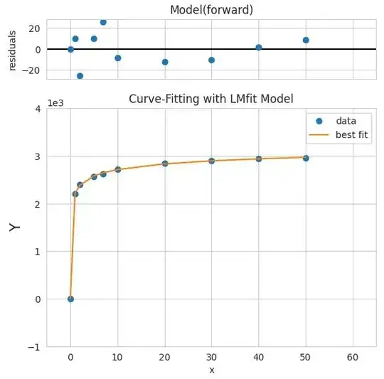

here my observation shows that when you set p0 within curve_fit() it perfectly fit over data.
According to DRY
- Fitting curve using lmfit package check its docs:
#!pip install lmfit
import numpy as np
from lmfit import Model
a = -0.007823866
b = 0.2984279
c = 0.1652267
d = 3512.422
def forward(x):
# create model from your model function
mymodel = Model(forward)
# create initial set of named parameters from argument of your function
params = mymodel.make_params(a=a, b=b, c=c, d=d)
x_data, y_data = df.X, df.Y
# run fit, get result
result = mymodel.fit(y_data, params, x=x_data)
# print out full fit report: fit statistics, best-fit values, uncertainties
#print(result.fit_report()) #error: ValueError: max() arg is an empty sequence
# make a stacked plot of residual and data + fit
plt.figure()
result.plot()
plt.xlim(-5, 65)
plt.title('Curve-Fitting with LMfit Model')
plt.show()
