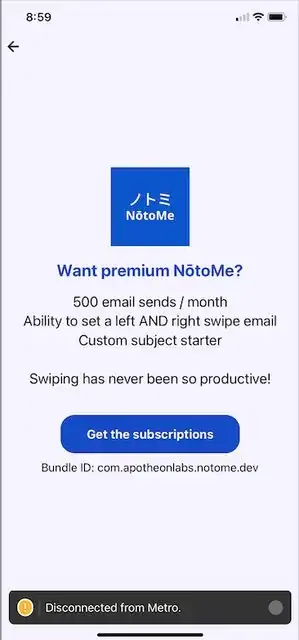

On the screen Iām screenshotting below, it shows the bundleID (read from {Constants.expoConfig.ios.bundleIdentifier}) and, if it can fetch offerings info, shows that.
I noticed today that when I build the app with npx expo run:ios, which ends up running on my computer on iOS Simulator, the code actually works:
But when I try to run the code via a development build, ie running eas build --profile development --platform ios to download it onto my phone then running npx expo start --dev-client, it still does not work:
Based on how RevenueCat works, this suggests an intriguing possibility: that in the first screenshot, it's reading the com.x.x.dev bundleID from my app.config.js, but is still using the old com.x.x bundleID behind the scenes.
I'm throwing this question to the Expo tag in the hopes my hypothesis is right - is there something different about how these two build methods work such that the former might be using a different (the original) bundleID in the background? Is there any way for me to check what is the 'actual' bundleID being used?
