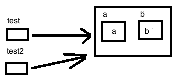

When you write {a: 'a', b: 'b'}, you are creating a new object in JavaScript. When you write it again, you create another object, although both objects contains the same values. When you attribute it to variables, the variables just contains references ("pointers") for each object. When you write
var test = {a: 'a', b: 'b'};
var test2 = {a: 'a', b: 'b'};
You got two variables pointing to two objects:
When you compare the two variables, you just compare the pointers. Since the two objects are different, the pointers are different and the result of the comparison is false. OTOH, if you have done the code below
var test2 = test;
the result is that test and test2 point to the same object and are equal.
(More about references on Wikipedia. It would be good to read about pointers too).
