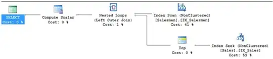

I have multiple tables in the workbook in different sheets. All the tables scope is Workbook as can be seen in the pic.
Using VBA, is there a way to get this object assign to a ListObject variable without defining the SheetName?
