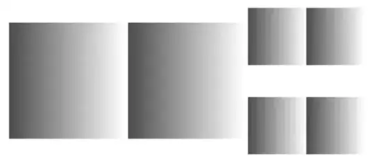

A minimal example would be the following plot, where two square images are displayed next to 4 smaller images in a nested subplot:

This results in the following plot:

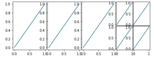

As you can see, the smaller images vertically use more space than the larger ones. I guess the nested gridspec tries to use all the available space, and is in no way restricted to match the two larger images on the left. On the other hand, it all aligns fine for plots with a flexible aspect ratio (e.g., line plots), as then the aspect ratio of the subplots stretches automatically:
(don't mind the overlapping axis ticks, it's easy to add more space if needed).
