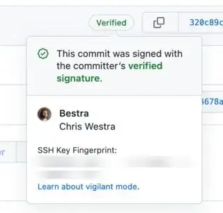

Note: commit signature verification is only supported by GitHub since Aug. 2022
It has to do with commit authorship verification, and nothing with repository access.
https://i0.wp.com/user-images.githubusercontent.com/4021812/186039068-d0d84d96-873b-44ec-8536-5e3e0ab648a3.png?ssl=1
But yes, you can use the same key if you want.
The idea remains, for commits marked as verified on GitHub, that other people can be confident that the changes come from a trusted source.
Said signature check can be validated on all computers by an SSH key synchronized with 1Password.
That differs with an SSH key used for GitHub authentication/repository access: in that latter case, it is better (better practice) to have on different SSH key per computer (in order to invalidate access from one of those computers, if it was compromised/stolen).
