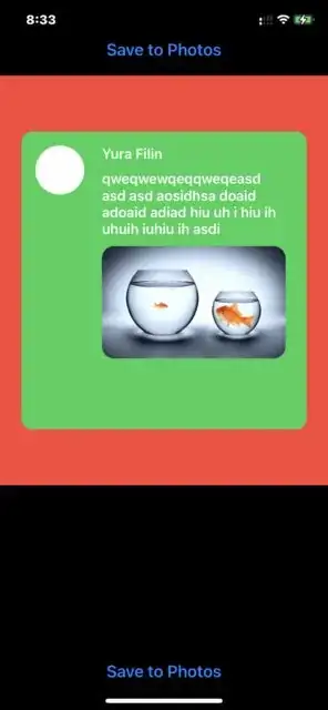

My goal is to convert SwiftUI view to image. I am currently building it for iOS 15 here is the code that converts the view to image

Expected result: https://share.cleanshot.com/5Pvzb7
Actual result: https://share.cleanshot.com/O4GKUF
Below is the body of the view that has a button and image view
