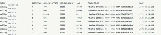

My script is designed so that batches of 20 'item groups', with up to 100 items in each group, are used to get the time-series data for each item in the group. This data is are stored as a nested dataframe relative to the 'item group' (see image below), and is used throughout the script to facilitate parallel processing on the selected batch.
