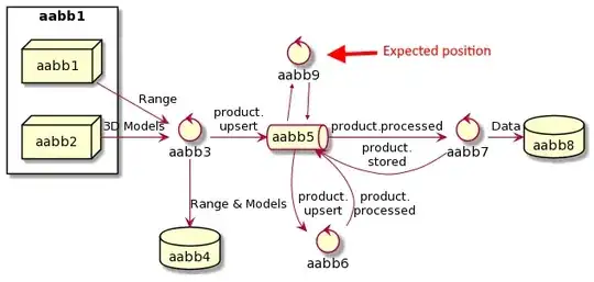

Another try at a semi-complicated deployment diagram (content is deployment:ish).
Background: I add components one by one, it works (see on plantuml server here)
until I get to "aabb9" (i e a9)...
Problem: When I add aabb9 to be the target of an "up" arrow from aabb5, I expect aabb9 to be placed above aabb5, where there is space. Like this:
Instead, the diagram layout is almost completely redone by the engine, and seemingly, the previously defined relationships are no longer "respected". So the (bad) result becomes:
Notice how the first nodes now come rightmost, and my relationships specified to be going to the right from those two (aabb1 & aabb2), are no longer "respected"/drawn as entered. Here is that same drawing with the line uncommented, and the "bad"/undesired result.
So, below here is the code that works, but if you uncomment the last line, it goes bananas and "relayouts" the whole thing.
Any clues to this? It would be cool to be able to create these simple diagrams with text...
Thanks! /mawi
