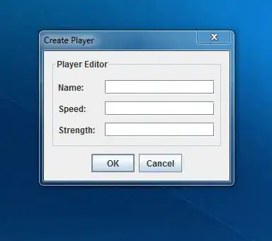

Here are relevant screenshots:
Chrome Sample Presentation API
