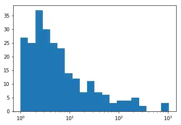

The following code indicates how you can use bins='auto' with the log scale.
import numpy as np
data = 10**np.random.normal(size=500)
_, bins = np.histogram(np.log10(data + 1), bins='auto')
plt.hist(data, bins=10**bins);
plt.gca().set_xscale("log")
