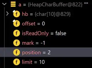

How to get the string "hi" from the CharBuffer? toString() does not seem to work.
val a = CharBuffer.allocate(10);
a.put('h');
a.put('i');
val b = a.toString();
Variable states after running the code above:
a.put('h');
a.put('i');
CharBuffer is pretty low-level and really meant for I/O stuff, so it may seem illogical at first. In your example it actually returned a string containing remaining 8 bytes that you didn't set. To make it return your data you need to invoke flip() like this:
a.put('h');
a.put('i');
a.flip()
You can find more in the docs of the Buffer
For more typical use cases it is much easier to use StringBuilder:
val a = StringBuilder()
a.append('h')
a.append('i')
Or even use a Kotlin util that wraps StringBuilder:
val b = buildString {
append('h')
append('i')
