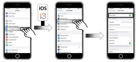

There's a new iOS 13 feature called Voice Control that may help you to control your application and your device more generally with your voice.
Activate this feature in your device settings Accessibility - Voice Control as follows:
Take a look at the Customize Commands menu to dive into the vocal commands.
The only thing to do as a developer is eventually to adapt the accessibilityUserInputLabels properties if you need specific names to be displayed for some items.
The Voice Control feature is definitely THE built-in tool to reach your purpose.
