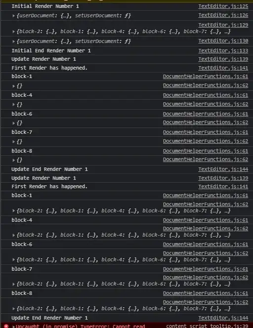

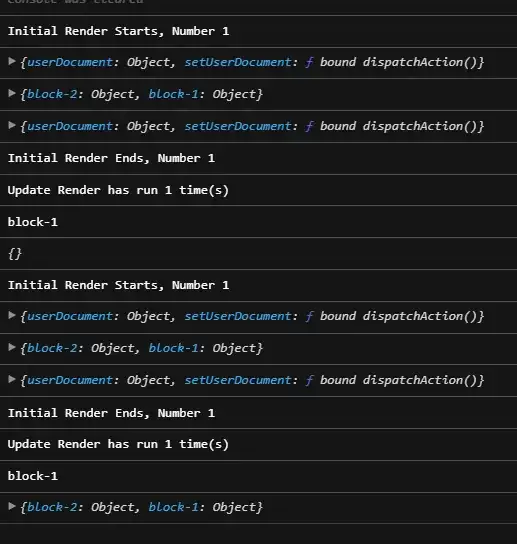

The interesting part with this was to see the difference between Codesandbox and my local development.
On Codesandbox Intial Render was called twice, but each time the counter didn't go up, it stayed at 1. On the other hand, on my local dev server, Initial Render was called only once.
On both version the second useEffect was called twice, but here also the counter didn't go up to 2, and stayed at 1.
Codesandbox:
Local Dev Server:

The error happens in this function:
function orderDocument(structure, doc, ordered) {
structure.forEach((el) => {
console.log(el.id);
console.log(doc);
// ordered.push(doc[el.id].headingHtml);
// if (el.children?.length) {
// orderDocument(el.children, doc, ordered);
return ordered;
The commented out code throws the error. I am console.loggin el.id and doc, and in the console you can see, that doc is empty and thus cannot find doc[el.id].
Someone gave me this simple example to my problem, which sums it up pretty good.
useEffect(() => {
documentCtx.setUserDocument('ANYTHING');
console.log(documentCtx.userDocument);
The Console:
ANYTHING
You can view it here: https://stackblitz.com/edit/react-f1hwky?file=src%2FTextEditor.js
