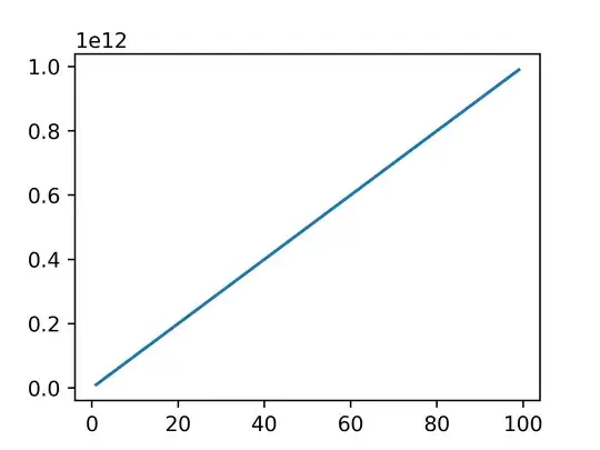

See the following figure:
I want the 1e12 text which is the Y axis offset (top-left of the top spine). ax.yaxis.get_offset_text() method is supposed to get it, but it gives me an empty string as shown in the example script.
