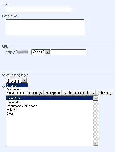

The 1st picture shows the layout in QTDesigner, the 2nd the result (emtpy tabs) when avoiding the crashing.
the QTabWidget has no problems in zeroing, or scale up, back to as many tab as I need, it's just that I have no clue on how to show the QTabview. My approach was to try to embed the QTabView in the tabpage passing it as parameter to the line creating the new QTabView.
